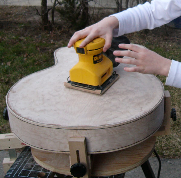

Hesh, the only downside I see with the Williams Jig is that you need a lot of bench space. That's why I went with the Ribbecke Jig. If it hadn't been for the fact that I build archtops I would have gone with the set-up you have (and haven't used as yet).
I can appreciate why some are not comfortable feeding a guitar into a router/jig (same reason I am terrified by router tables). But it works for me. The craddle is really handy for other jobs such as sanding and is virtually child proof as shown below
